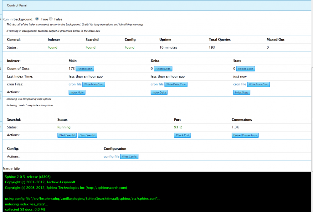

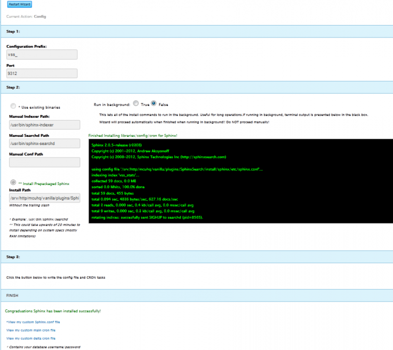

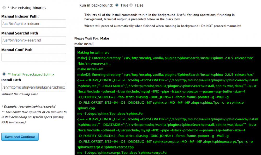

Enable URL Rewriting ($Configuration['Garden']['RewriteUrls'] = TRUE)No backend knowledge is required to install this! Everything is done for you via the install wizard. It comes bundled with the build of the sphinx search engine. To install, run the install wizard and complete the **3** step process. If the wizard encounters any errors, it will tell you. If the installer package does not work on your server, you can perform a manual installation via your distro's package manager and then tell the wizard where to find your installed files.
To enable the plugin, simply download it from Vanilla Forum's plugin portal and move it to your webserver's plugin folder. Enable it from the dashboard. Some files need to be given write permissions by the installer:
* ~SphinxSearch/Install folder
* ~SphinxSearch/Install/pid/error/output.txt files
The install process allows you to run long tasks, such as *./configure* and *./make* in the background. While this is going on, the terminal output will be presented to you. This is also possible to do while indexing your indexes, which may take a long time depending on the amount of documents in the database.
After installation, do the following in the control panel:
1. Start searchd
2. index 'Main'
3. index 'Delta'
4. index 'Stats'
5. Stop and then start searchd again
6. Search for something on your forums through the usual means
7. Setup a cron job to run the three cron files
8. DELETE ALL FILES IN YOUR /cache folder!

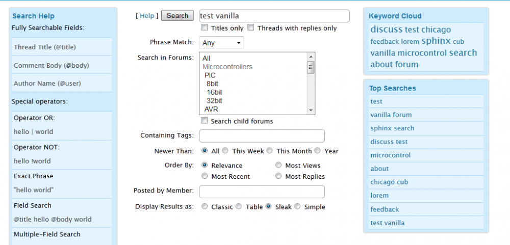

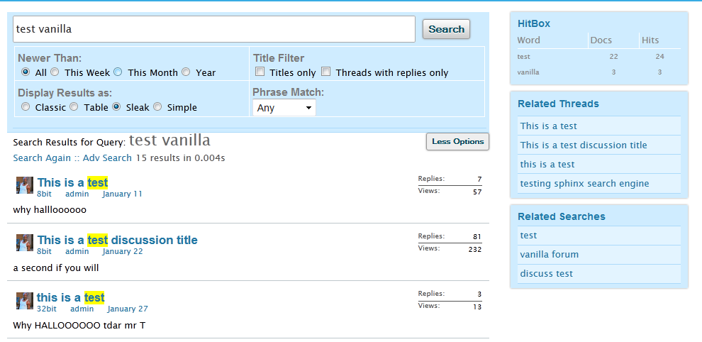

- Whenever the advanced search is expanded, the div will stay collapsed for subsequent searches until it is toggled

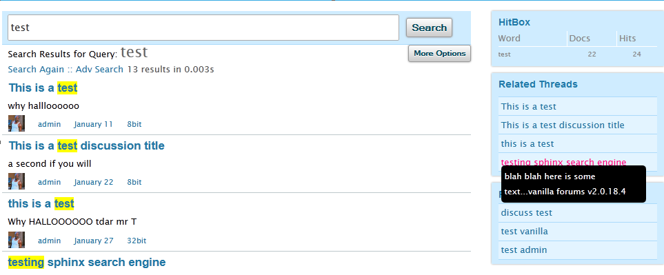

- Fixed a bug where the xx amount of search results were not being reconstructed back to their original ranking order from sphinx. This caused the results within each page to be mixed randomly!
- Fixed a bug where sometimes the results will say "xx results found" but no results actually shown. This is because the default page landing was NOT being set correctly to 1. This is repeatable when a
previous search on a large page number is then followed by a search that returns a few results on a smaller pagination scale than the previously viewed one. No results will be shown since the GET query string tells sphinx to return the previous search's offset - Instead of checking if sphinx is installed and ready, the plugin now forces the default search to ALWAYS be sphinx until the plugin is disabled. Any errors should now be spit out on any page that fetches a query from sphinx

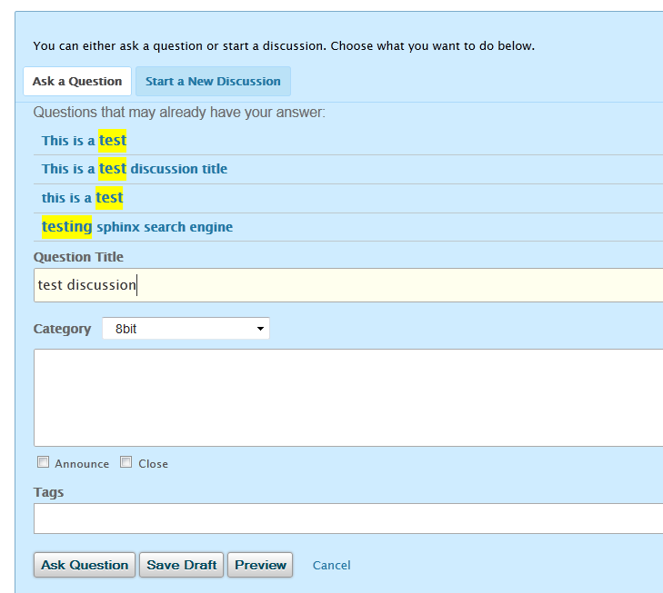

- Fixed issue where regular users could would not see the suggested threads when starting a new thread

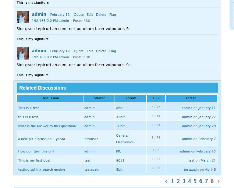

- Added permissions check for related discussions o main/regular discussions view
