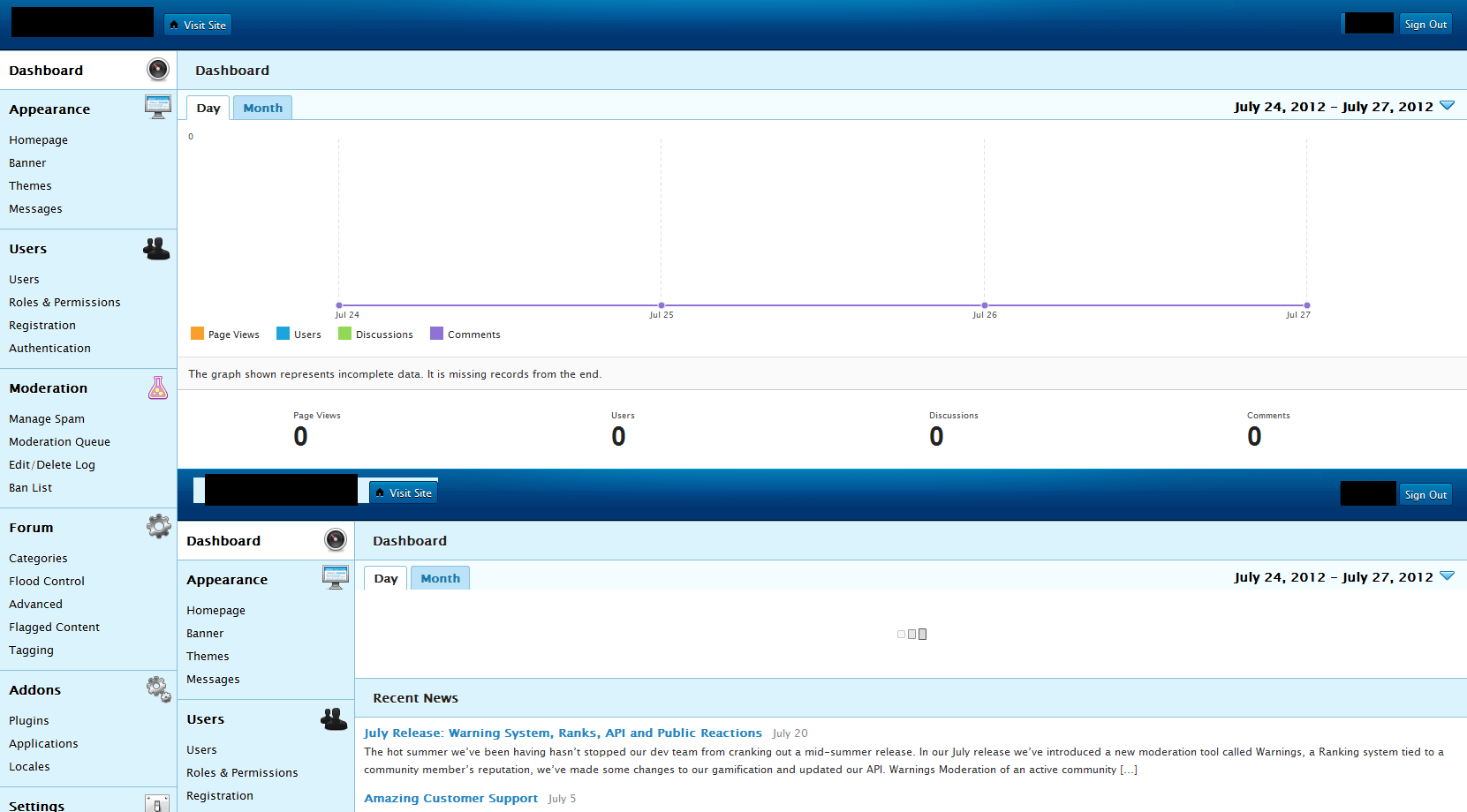

Enabling the Vanilla Statistics plugin causes the dashboard front page to be displayed again inside of itself—looks like this. I can duplicate the behavior in Firefox, Safari, and Chrome. Is this just a 2.1 incompatibility that will eventually be fixed, or am I doing something wrong?

It's something to do with a rewrite rule, because when I set
$Configuration['Garden']['RewriteUrls']toFALSEin the config.php file it goes back to working normally.Attached is a screenshot.
