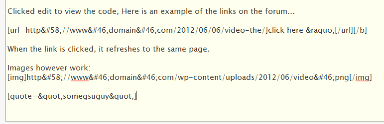

  • I was able to transfer/convert the forum to a test forum.... now my only problem before I decide to go live is, all my urls/links in posts are broken. I am assuming it is because of the bbcode urls. I have been searching for a solutions.
    the same with quotes being broken etc. I don't mind everything else if I get the urls fixed.
  • Instead of saying the links are broken highlight one of your links and post an example of the link. Could be your .htaccess or whether it is embedded or whether you use the url modifier.
    also what is the format column saying for the comments and discussions tables.
    Does it bbcode , html, raw , whatever.

  • peregrine said: Instead of saying the links are broken highlight one of your links and post an example of the link. Could be your .htaccess or whether it is embedded or whether you use the url modifier.
    Hi peregrine,
    Thank you for the response. I have attached a screen capture of a code, seeing as it kept on converting when i previewed it.
    771 x 250 - 143K
    UnderDog
  • x00x00 Don't PM about development, I'm not currently taking on clients MVP
    edited July 2012
    this is an issue with phpBB, it has a of unnecessary artefacts.
    You can use my version of the porter which has a bunch of phpBB fixes
    https://dl.dropbox.com/u/15933183/porterplus/porterplus.php
    Don't PM about development, I'm not currently taking on clients.
    grep is your friend.
  • Hello x00, I used your plugin, and at first look, It seems to have done the trick, thank you so much. The links work, and from what I've seen from the threads I clicked, the bbcodes are now all html.
