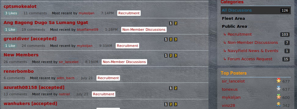

How do I add elements beside the Discussion Title (not below it)? It can be anything - text, link, etc. I am actually thinking of putting the Front Page Discussions Pagination plugin beside the Discussion Title, instead of below it.
The title anchor is display: block via css. You can change it back to display: inline in your theme and then whatever you echo in the AfterDiscussionTitle event will show up beside it.

Yes, I've seen that code. The pagination plugin uses < span > after the discussion title < div > but since the < div > uses display:block, the < span > is forced below the < div >. Setting the < div > to display: inline doesn't fix it.

It turns out Todd and Underdog are correct. I was taking a hard look at display: inline all this time but was not sure which selector was responsible.
I thought .DataList .ItemContent was it but as Todd and Underdog pointed out, .DataList a.Title is the right selector.
The only (minor) problem is, by setting display: inline, the discussion title (if very long) flows to the right side overlapping the "options" FlyOut Menu but I can live with that. (Or perhaps that's another issue to tackle.)

3 • Off Topic Insightful Awesome 3LOL •Yes, I've seen that code. The pagination plugin uses < span > after the discussion title < div > but since the < div > uses display:block, the < span > is forced below the < div >. Setting the < div > to display: inline doesn't fix it.

0 • Off Topic Insightful Awesome LOL •It turns out Todd and Underdog are correct. I was taking a hard look at
display: inlineall this time but was not sure which selector was responsible.I thought
.DataList .ItemContentwas it but as Todd and Underdog pointed out,.DataList a.Titleis the right selector.The only (minor) problem is, by setting
display: inline, the discussion title (if very long) flows to the right side overlapping the "options" FlyOut Menu but I can live with that. (Or perhaps that's another issue to tackle.)- Spam
