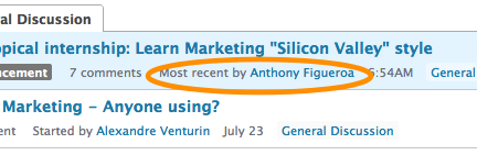

Can anyone point me in the right direction to make my "most recent comment by" links actually GO to the Most Recent comment rather than the user profiles??

@UnderDog Apologies I misspoke. I don't have any special plugin activated that changes the sort order. I thought for some reason there may have been an option within the Vanilla settings and I set it that way, but now I'm realizing I have it the same default way everyone else probably does (confused with other forum scripts)
Anyways, okay so the issue is that my forum is embedded within a WordPress page. I realize that you use # hash anchor links to jump to the latest comment, and if I were to go straight to my Vanilla install, that appears to work, however because I am forcing links back to the embedded forum within WordPress, somewhere along the line it removes those #hash anchor links and just lands me & other users on the top of the page.

0 • Off Topic Insightful Awesome LOL •most recent comment by is not a link, the author however is a link to go to the author.
if you want to get an idea how you could change things look in the pagenavigator plugin for ideas.
For example, when you hover or copy the link within the forums, it will look something like this:
http://domain.com/vanilla/discussion/230/topic-name#Item_5
But when it redirects back to the embedded form, it loses the anchor and ends up looking like this:
http://domain.com/routeto/forum/#/discussion/230/topic-name
So that's whats happening for me. I have scoured and scoured the support forums here and the rest of the web via google search and I cannot seem to find an answer to this. Is it possible I'm an idiot and I have something conflicting in my .htaccess settings or WordPress Redirect plugin?? Probably. If so, if you have any good ideas, I'm more than open to hearing them.
Also though, is there a way to get Vanilla to write it's URLs the latter way rather than the former way (i.e., with my embedded address) so that opening threads in new tabs doesn't actually load Vanilla, then redirect back to the embed? But instead take them straight to the embed?
