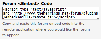

    In my Vanilla install under embed I have the Embed-Friendly theme and the js that Vanilla tells me to use is: image

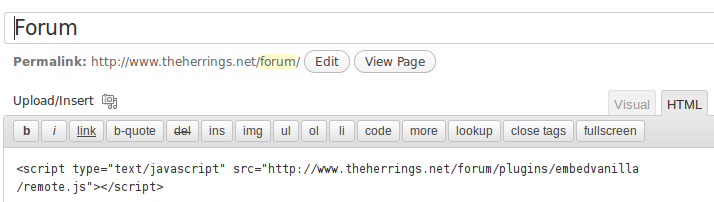

    As previous instruction I have followed on here in WP I have installed the Vanilla embed plugin which is 1.1.12. I then created a page called /forum and inserted the Vanilla js into the HTML: image

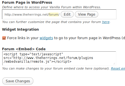

    In the WP plugin intergration it gave a slightly different js path. image
    I changed this to the Vanilla given path I put the url in the plugin and saved: image

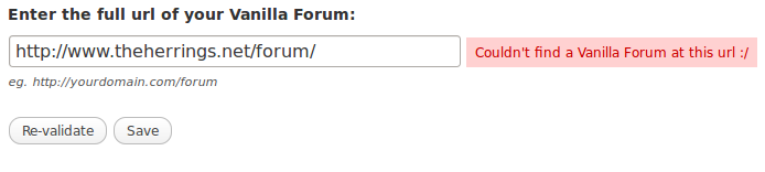

    Finally I went to the set up and put the url in there as well; but I am getting an error message that it can't find the forum install. image

    Anyway the update didn't solve the problem. I have a strong feeling that the error is due to the WP plug in not finding the vanilla install since the error message is: Couldn't find a Vanilla Forum at this url :/
