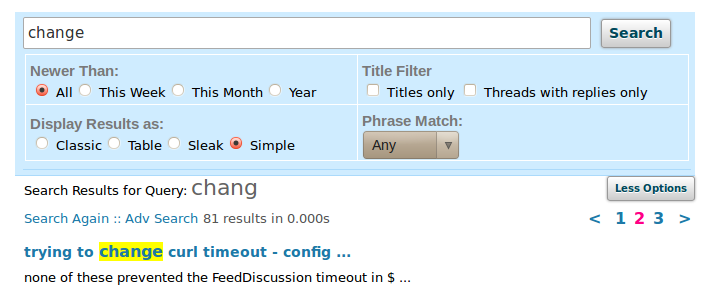

    question when you change display results to simple view in image below, it works when I click go button (not in image but upper far right )
    should the same thing happen when I click the search button and view will be simple (I don't seem to see that happen).
    you have a good idea to stack up your changes before releasing new version instead of releasing new version after every change.
    708 x 292 - 35K
  • should the same thing happen when I click the search button and view will be simple
    Yea, the search button that is included in your snapshot should also then change the view to be 'simple'
